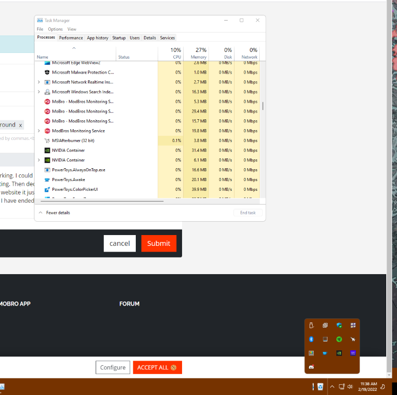

About a month after installing windows 11 and configuring my modbros to work with everything it stopped working. I could see it running in the background with through task manager. It was not in my system tray as a running program though. I restarted and did the basic troubleshooting. Then decided to uninstall and reinstall based on a similar issue  I found online. However, now when I got to download the newest version of the software from modbros website it just flashes the name on the screen for a moment and then turns off. It is showing in my task manager but again not in my system tray and I can't do anything with it. I have ended its task and tried restarting the process but it does the same thing. I have also tried downloading the software multiple times.

Ah, the folder was hidden and when I updated to windows 11 it set the default to not show hidden folders again. Thank you I found it and just deleted everything now I can reinstall
