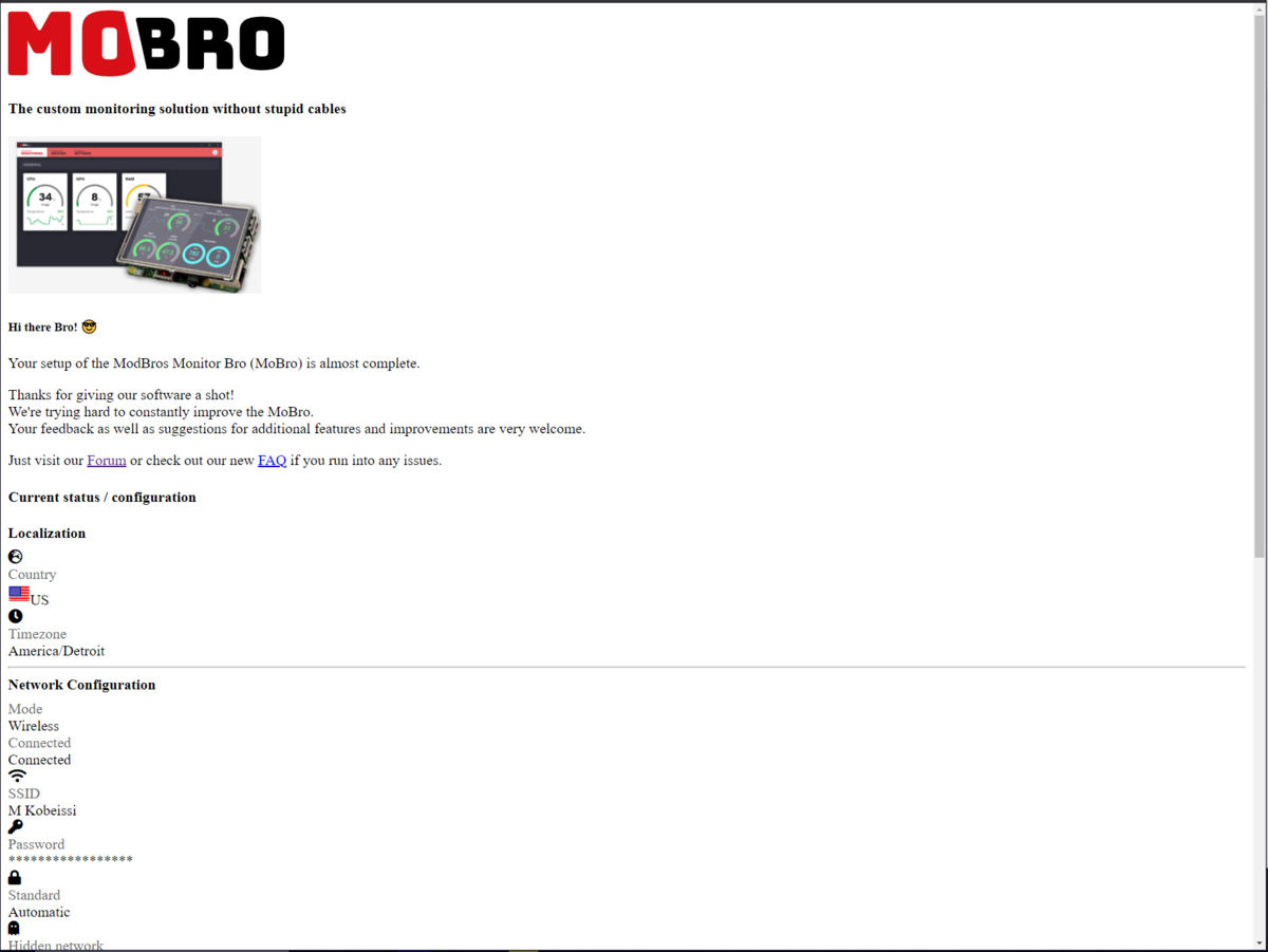

Whenever I type in the IP of my PI, I see a broken configuration page.
Error in the console is
Uncaught TypeError: Cannot read property 'fn' of undefined

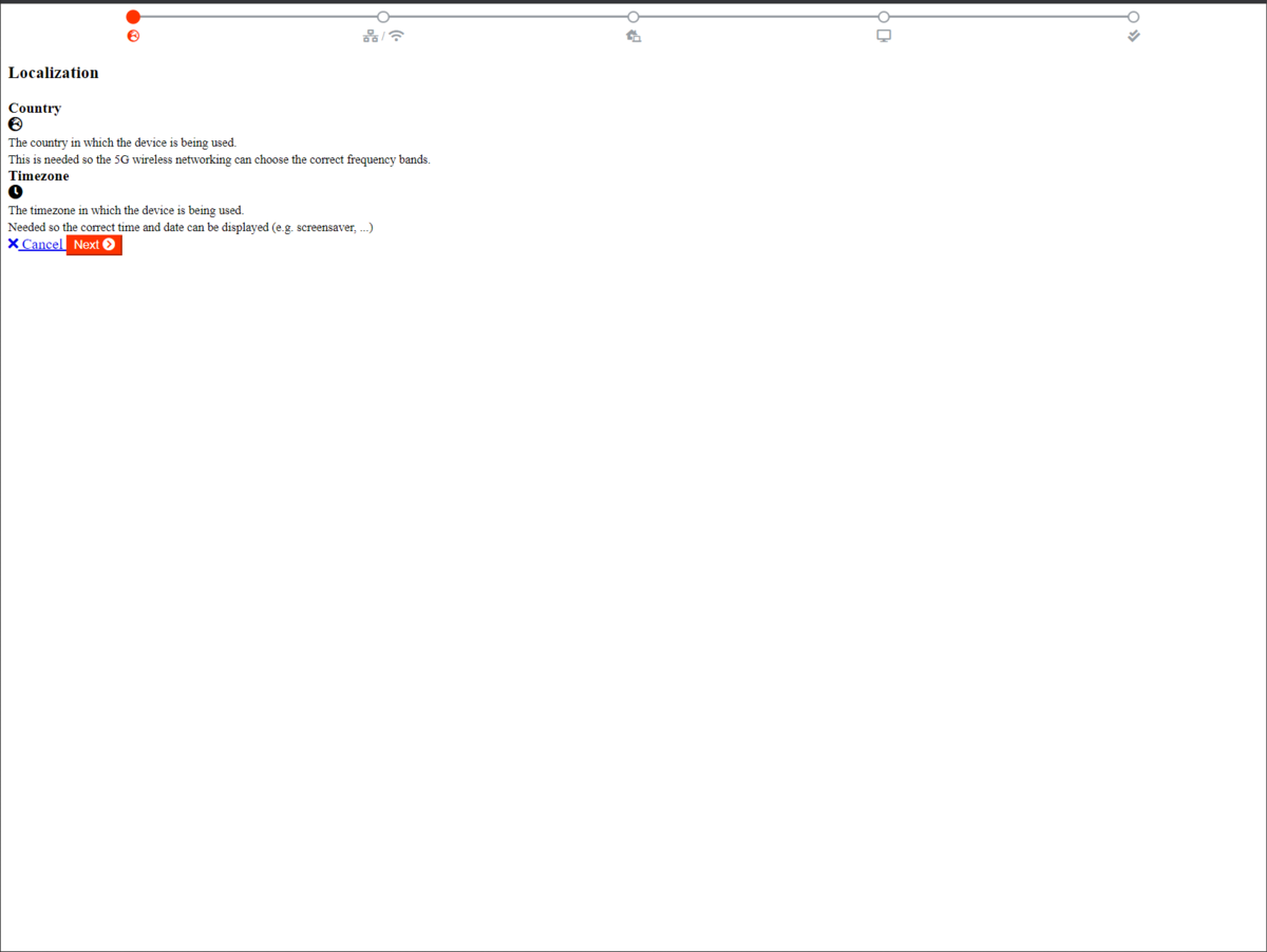

If I tap on configuration wizard, I see this:
The button here is not clickable and I see this in the console:
util.js:55 Uncaught TypeError: Cannot read property 'fn' of undefined
    at util.js:55
    at bootstrap.bundle.min.js:6
(anonymous) @ util.js:55
(anonymous) @ bootstrap.bundle.min.js:6
bootstrap-select.min.js:8 Uncaught TypeError: Cannot read property 'valHooks' of undefined
    at bootstrap-select.min.js:8
(anonymous) @ bootstrap-select.min.js:8
wizard.php:713 Uncaught ReferenceError: $ is not defined
    at wizard.php:713
(anonymous) @ wizard.php:713
DevTools failed to load SourceMap: Could not load content for http://192.168.1.202/vendor/bootstrap-select.min.js.map: HTTP error: status code 404, net::ERR_HTTP_RESPONSE_CODE_FAILURE
I already tried resetting the configuration using the clean.sh script and starting over but it does the same thing after the initial configuration. Everything works fine on the first setup.

Hi @kobeissi2
Never seen that issue before until now, so I will have to look into it.
But from your description i suspect there might be something wrong on saving the initial configuration
So after you applied the initial configuration and the Pi rebooted, could you open this page in a browser and post me the response that you get: [IP_ADDRESS]/api/configuration
Just so we can check if the initial configuration was indeed saved correctly

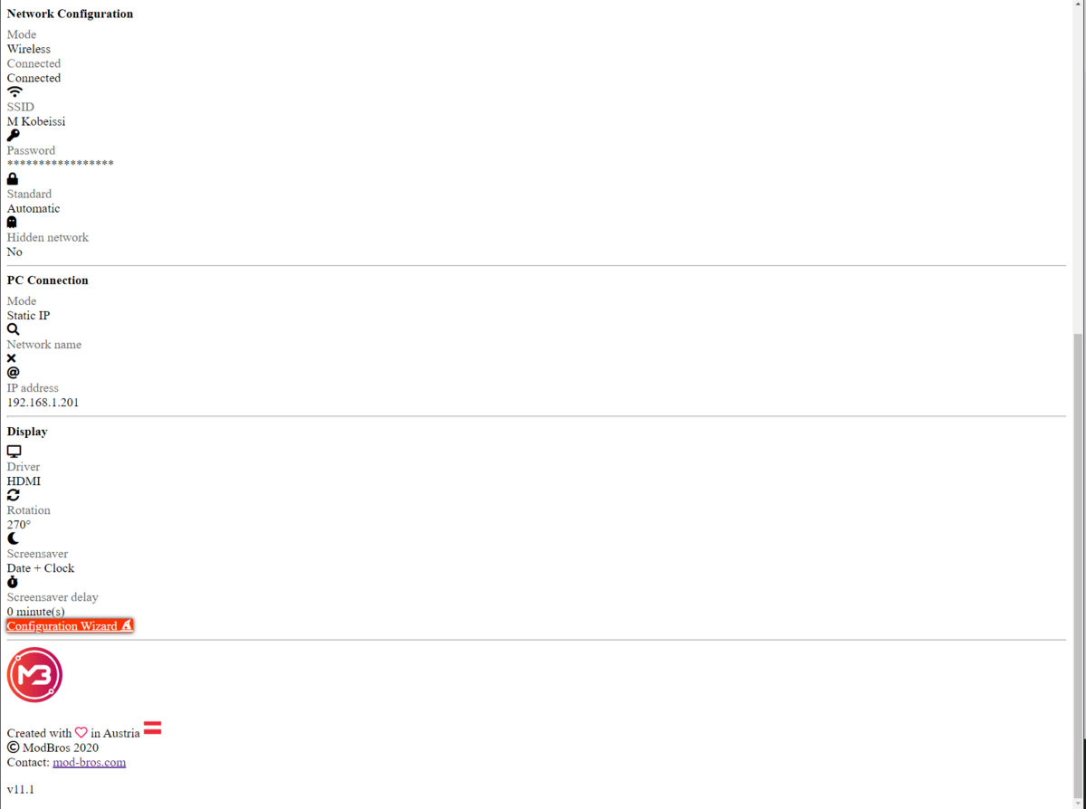

Hi @Seraksab,
It looks like it is saving.
localization_country=US
localization_timezone=America/Detroit
network_mode=wifi
network_ssid=M Kobeissi
network_pw=[redacted]
network_wpa=
network_hidden=0
discovery_mode=manual
discovery_key=mobro
discovery_ip=192.168.1.201
display_driver=hdmi
display_rotation=270
display_screensaver=clock_date.php
display_delay=0
Yes that configuration looks correct.. ?
