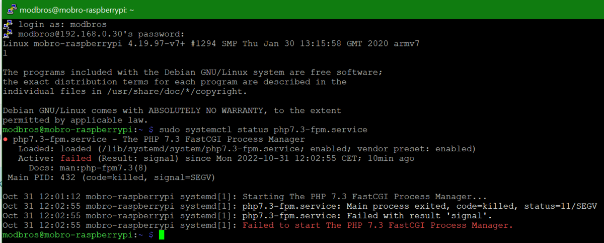

On boot ist says “Failed to start The PHP 7.3 FastCGI Process Manager”. After that message the screen just goes black.
I googled it and found a prompt to display the status:
What can i do to resolve this issue? I dont really know to handle Linux.

Maybe some files got corrupted on the SD card over time.
I guess the easiest solution would just be to re-flash the image. Especially if you don't know your way around Linux.
