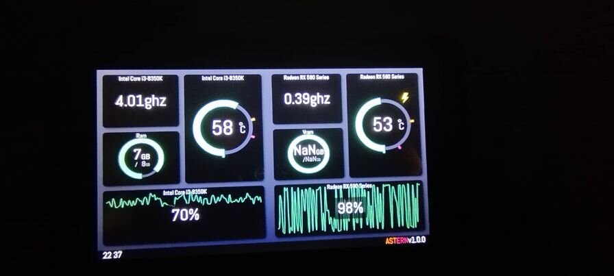

Recently i started noticing this yellow symbol appearing and disappearing every couple seconds, anyone know what it means?

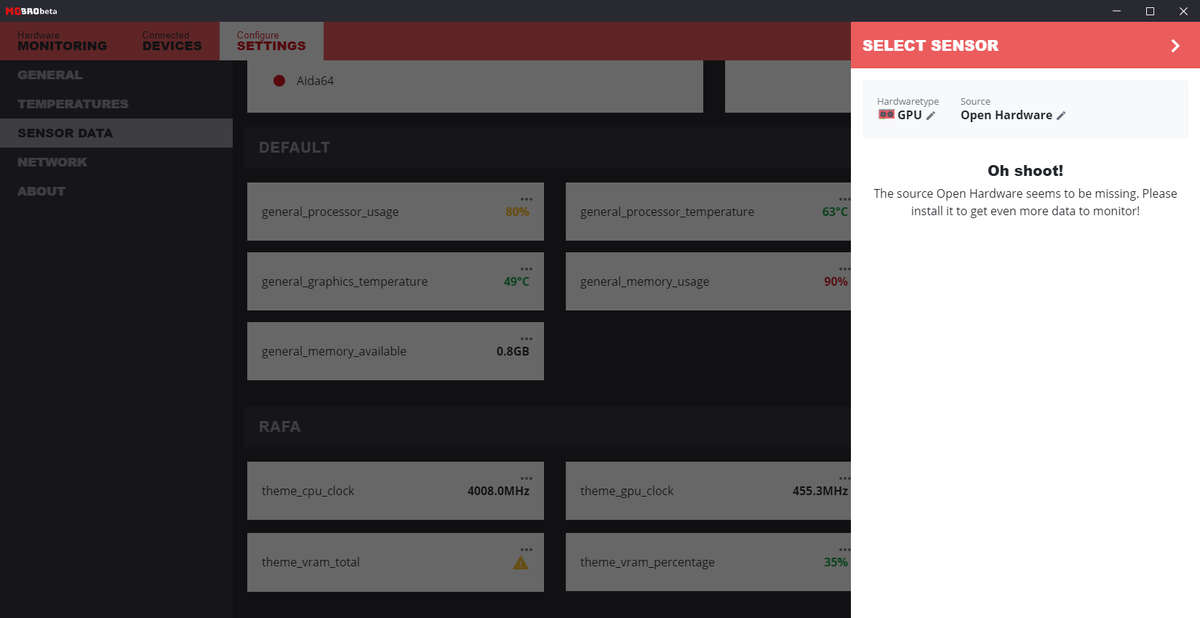

Also it's not counting how much VRAM it has, i've checked in the app “Settings”, “Sensor Data” and i get this message shown in the image below for both “theme_vram_total” and for “theme_vram”.

Hi @Faria
The lightning icon is displayed when the power supply to the Raspberry Pi drops below 4.63V (±5%).
This is not a icon from the theme, but an overlay from the Raspberry Pi itself.
You can find the official documentation here: https://www.raspberrypi.com/documentation/computers/configuration.html#undervoltage-warning
If the icon keeps showing up you should consider using a more potent power supply.
