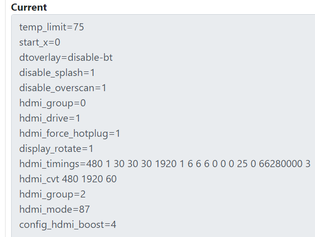

Hey @GhosTz
I've been trying loads today and i figured out i had to add this line to get full-res:
dtoverlay=vc4-kms-v3d
I also shortened my config file to this:
hdmi_cvt 480 1920 60
This seems to give constant full resolution!
However, this breaks something else. I can't, for the life of me, rotate the screen. I need to rotate it by 90 degrees, and i simply cant. Not with the built in rotation on the config page, and also not with commands. Kind of lost right now.

Hey @GhosTz Did you have any succes so far? I still have not succeeded in rotation, even when using xrandr.
Hey Liam,
I've now tested it on my screen. I first needed to figure out what screen I had to find the right settings. For me it's a Wiscoco 1920x480 IPS LCD screen with the model name HSD088IPW1-A00.
On first setup nothing displayed on the screen, so I used the model number to find these settings on google and they worked instantly:
max_framebuffer_height=1920
hdmi_ignore_edid=0xa5000080
hdmi_timings=480 1 48 32 80 1920 0 3 10 56 0 0 0 60 0 75840000 3
hdmi_force_mode=1
hdmi_drive=1
config_hdmi_boost=4
Default orientation was portrait. I personally wanted to have it landscape so I added these props to the config.txt as well:
display_hdmi_rotate=1
Hope these settings work for you as well.
That indeed seemed to do it! Thank you so much :D
BRILLIANT!! the HDMI timings were the key. The screen now works with a standard pi OS, so I will now flash with Modbros

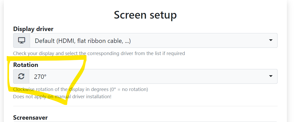

Hi
So I think you may be doing what I did (which unfortunately is over-complicating the whole process). I spent hours trying to rotate the image with a Pi4 to no avail….so I simply scrapped everything in the config.txt and just did the below, as added in the ModBros Setup
max_usb_current=1
hdmi_timings=400 0 100 10 140 1280 10 20 20 2 0 0 0 60 0 43000000 3
Then to rotate, I also did this in the ModBro setup
