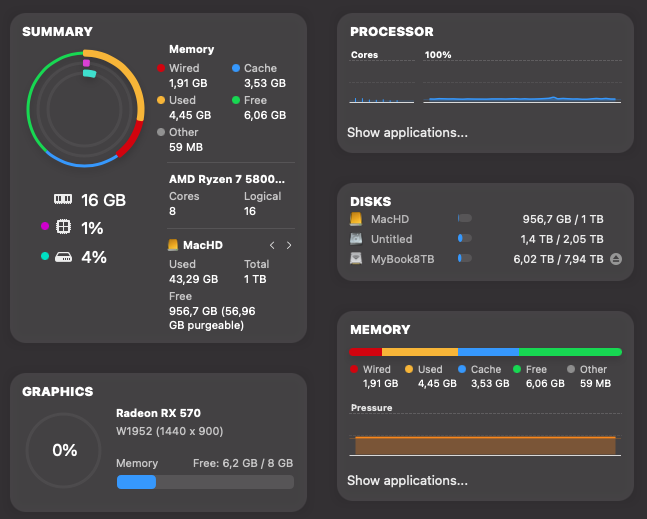

  1. First of all, install iStatistica Pro on your Mac or Hackintosh, and activate the remote monitor
  2. Change the web.html in the Application Contents inside the Resources folder to match the looks and size of the rpi screen (mine here is 800x480)

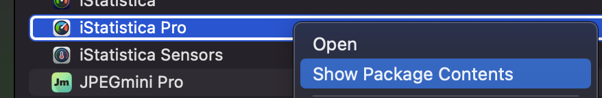

You go to your Applications folder and right click on the iStatistica Pro and then choose application contents and navigate until you find the Resources folder.

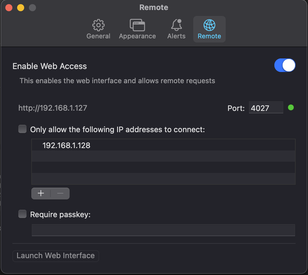

Make sure you enable the Remote Web Access in the iStatistica Pro Settings

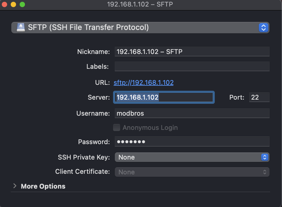

To change these files you need to access via SFTP.
Using CyberDuck point it to the IP address of your RPi and for the credentials just use modbros as the username with password modbros.
After connecting just browse to the following folder: /home/modbros/mobro-raspberrypi/web/screensavers

IMPORTANT: Make sure you CHANGE the IP addresses on clock_date.php source so they match your Hackintosh and your RPi IP addresses.

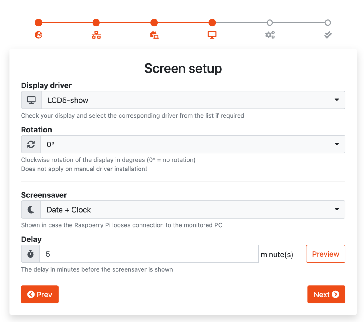

Set the Date + Clock Screensaver through your Mobro configuration Wizard (if you haven't already) and set the Delay to 0 (zero).
Please bear in mind that the mobro service on your RPi will try first on boot sequence to find your Mobro PC Application, and only after that will launch the screen saver and in it the “detection” javascript.

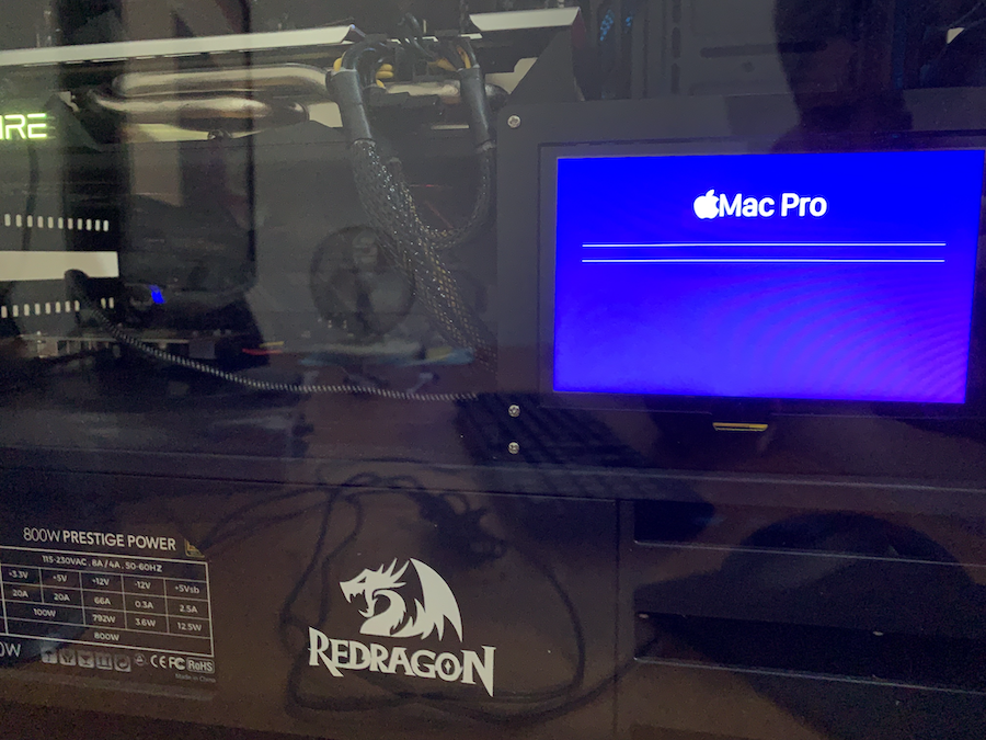

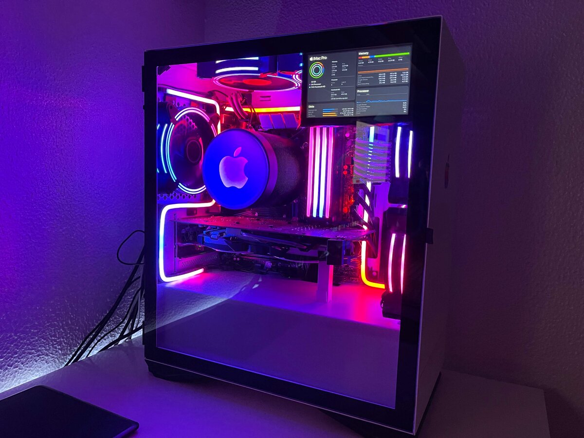

Sucesso!

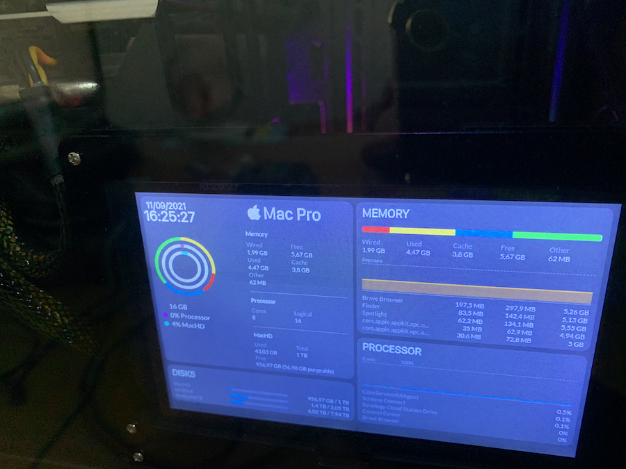

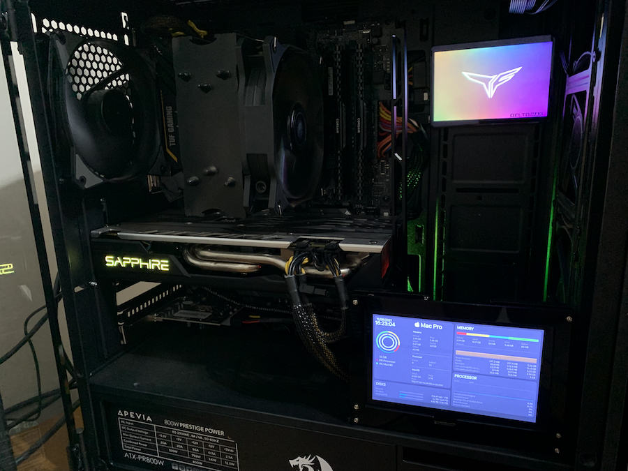

I manage to follow your instructions and now I have a beautiful statistic screen on the screen of the Raspberry Pi. Unfortunately I have one little problem, with the screensaver, it doesn't show the time and date.
Kudos to you for creating this method to make ModBros work on a Mac.
Here are my pictures:

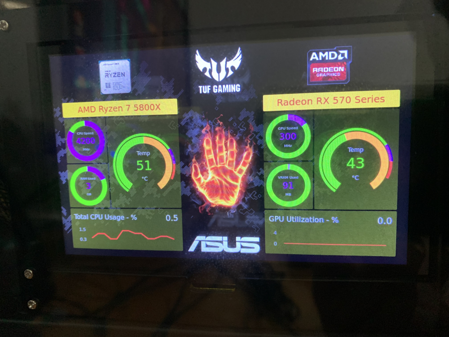

This is what it looks like when I´m on Windows.
That's Great!!! :) Looks Perfect

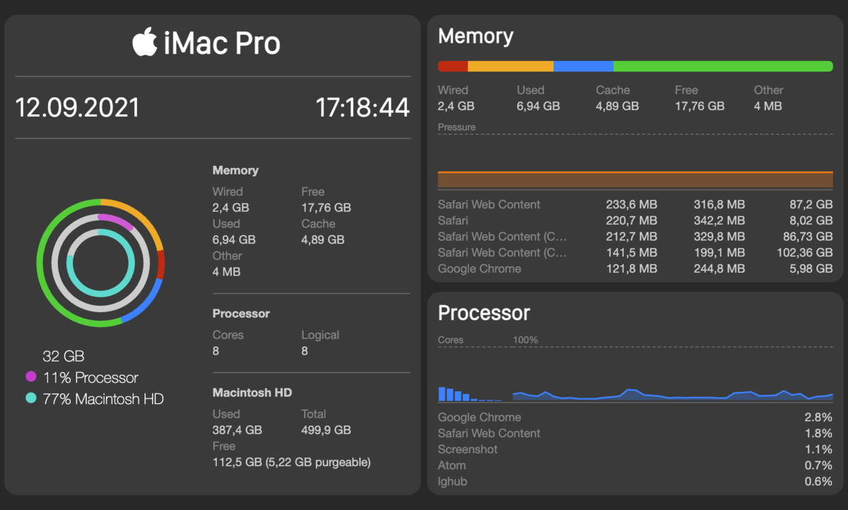

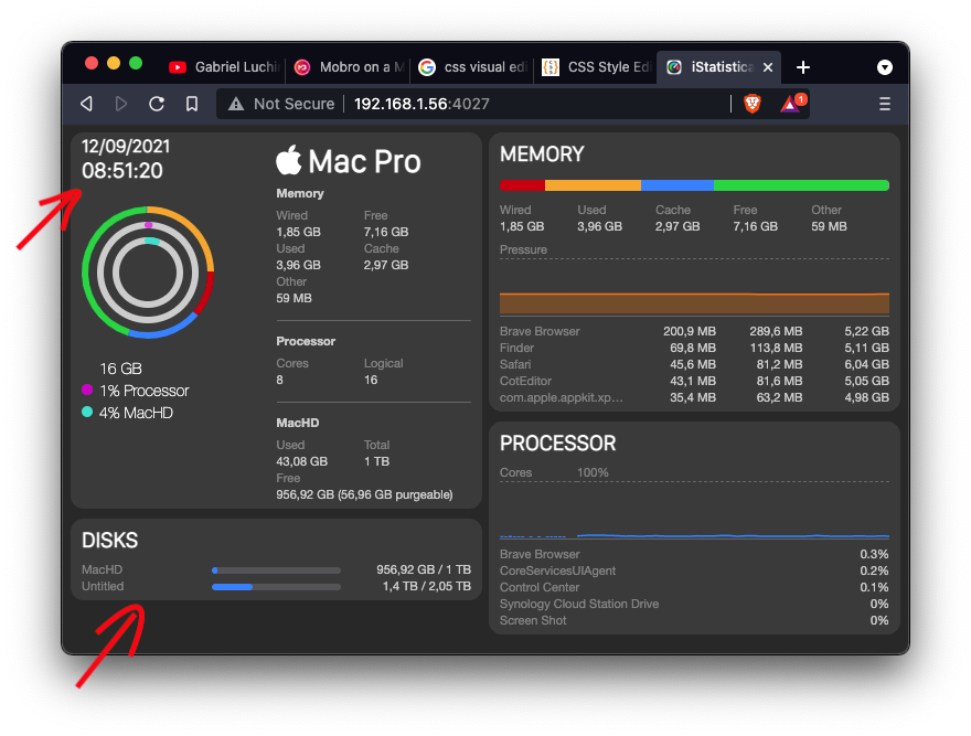

I made some small changes to the iStatistica Pro web.thml and theme.css. I don't think I can make any other changes. I'm very limited in CSS.
I made the clock smaller and give a bit space between date and time lines.
I would like to get ride off this dent, and make both bottom match, but I wasn't successful.
That is nice too, good design.
Is there a way to make the correspondent colors from circle graphic appears on each side of the item?
Also I think in the card of Memory and Processor, the list of opened files is redundant and I would cut it out. this could make room for other card with information on the graphic card.
Is it possible to get the model of the machine on the title from iStatistica, because it has already it?
Is it possible to come more near to this?
But maintaining model name and the date and clock like you did?
What do you think?
ps: Don't mind to the large spaces between card.
I noticed that the clock is running and I think it is justified by the right side making the numbers jump when they change.
Could you justify to the left? Maybe switching sides with date, it could solve the problem too.

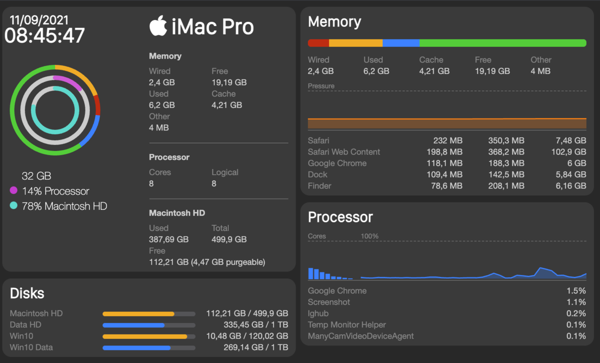

Well I think the best I could do right now is this one:
Made the fonts a bit bigger. Can't seem to fit anything else.
I'm using the code made by the iStatistica Pro maker for the web interface, and making adjustments on the CSS and HTML.
The GPU info has a dropdown that doesn't look very elegant.
If you're interested in this version here is the link to download: https://nhcjec.s.cld.pt
