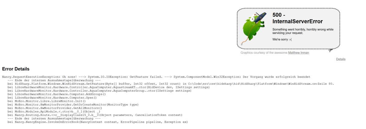

The response to ‘http://localhost:42001/api/sensors/data’ :
I have both folders
If i run the “ModBrosMonitoringService.exe” in MoBro_Local a console window pops up, but closes atomatically in seconds.
Reinstalling everything didnt work either.
Played around with it last night a lot, and i got it to work on one reboot. Sadly after another reboot it was gone again ^^ Didnt change anything in between ;(
Alright, that doesn't look good ?
So the service is in fact running (as shown in services.msc) but you can't get any data from it because an error occurs when trying to.. :/
So that's why you're getting those ‘service not running’ error message, as the app can't get any data from the service

From the message you posted, it seems like the error is thrown when LibreHardwareMonitor is trying to access something from AquaComputer
If yes and it's not too much of a hassle, could you test unplugging the USB connection to see if that's indeed the cause of the problem?
