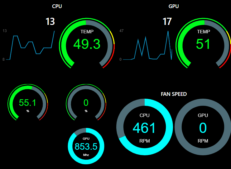

Hey guys,
first of all, thanks for that great project. I'm using my Pi with the standard image to show the web theme dubbadhar on it.
I already did some changes to the theme and it worked fine so far. I changed some stuff inside the index and the theme-config.json.
