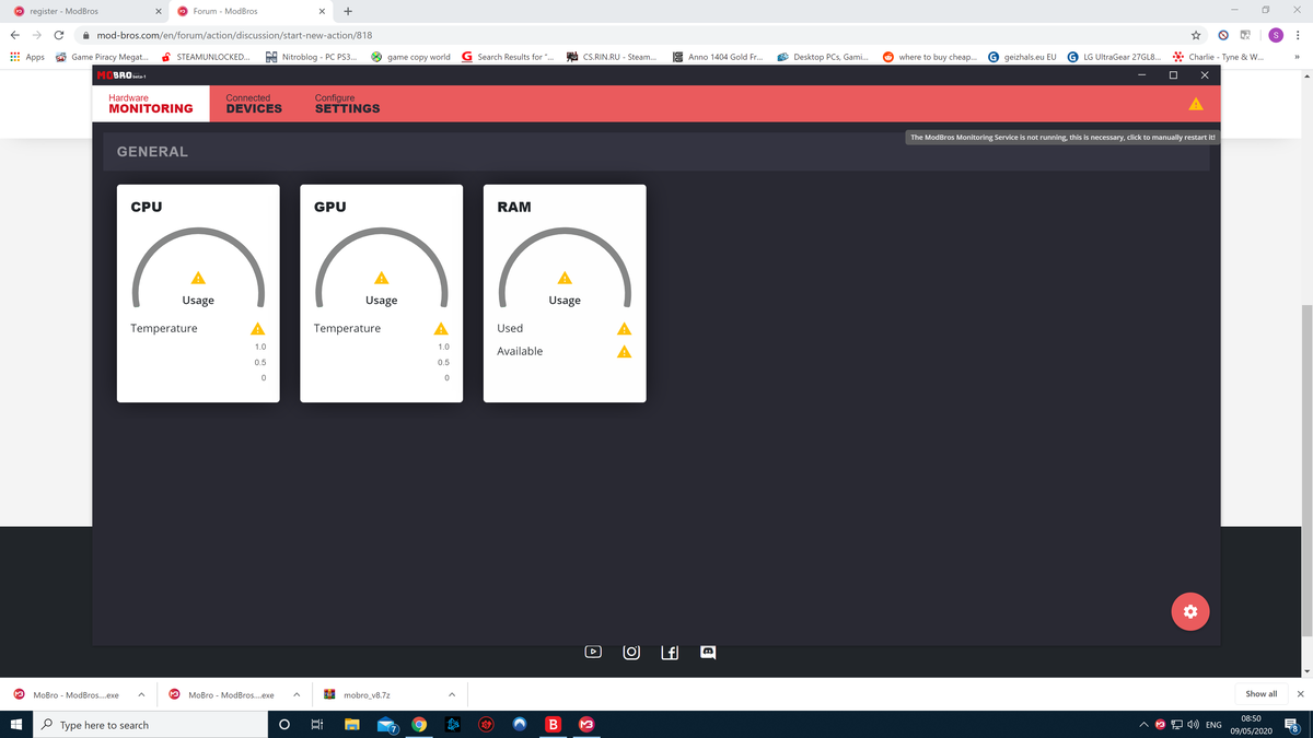

Monitoring service not running
I have ran the EXE as an admin but cant seem to get the app to work. i have even disabled my firewall and antivirus. the app loads but it says the motoring service is not working.
Hi wkdsean
Your firewall and antivirus should be no problem in this case.
Could you please check if the service was installed correctly by doing the following:
  1. press the Windows Key + R
  2. type "services.msc" in the appearing box and click OK
  3. check the services list if the "ModBros Monitoring Service" is there and whether the status column says "Running"
  4. If its there but not running, right lick on it and try to start i manually
Also did you right away install the 1.0.0-beta1 version or did you already had the previous version installed and upgraded to the new one?
Im having the same issue. App has been installed but the service never does. No errors pop up as far as i can see.
I have uninstalled and reinstalled but the service never installs.
Any ideas?
RESOLVED: OK, go it all working after a reboot.
You should really put a mandatory reboot in after install.
Thanks
All working now after reboot.
