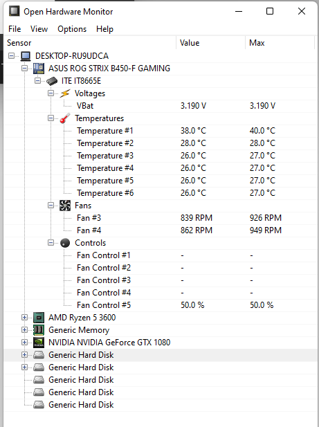

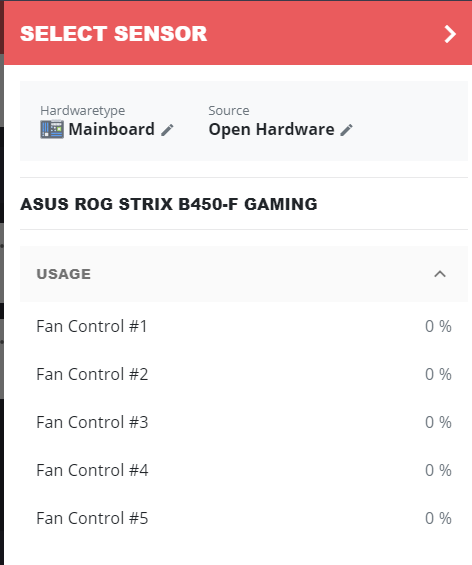

Hi, I have an odd problem with FAN data
The fan control reporting through modbros is all at 0
when i look at open hardware monitor , it shows different
is there a config or something i can change?
