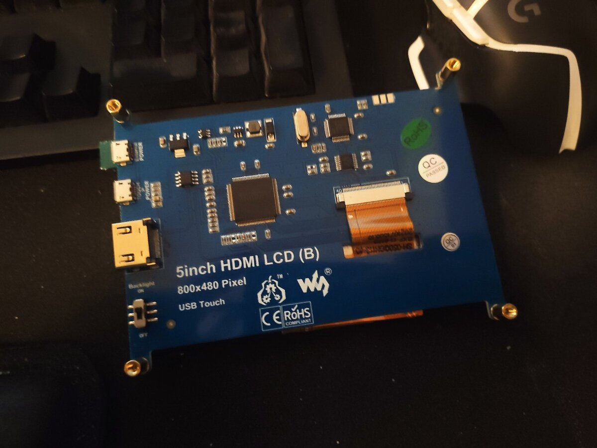

We've now gone ahead and just ordered that exact Waveshare display you linked
I'll have a look at it and start testing once the display arrives

so the display arrived and I already did some testing with a Pi 3 B+ and v12.3 of the image
I've only selected the 'WaveShare - LCD5-show' display driver in the configuration wizard
nothing else, also no custom settings in the advanced section
after applying the configuration and waiting for the Pi to reboot twice (!), the display works just fine for me

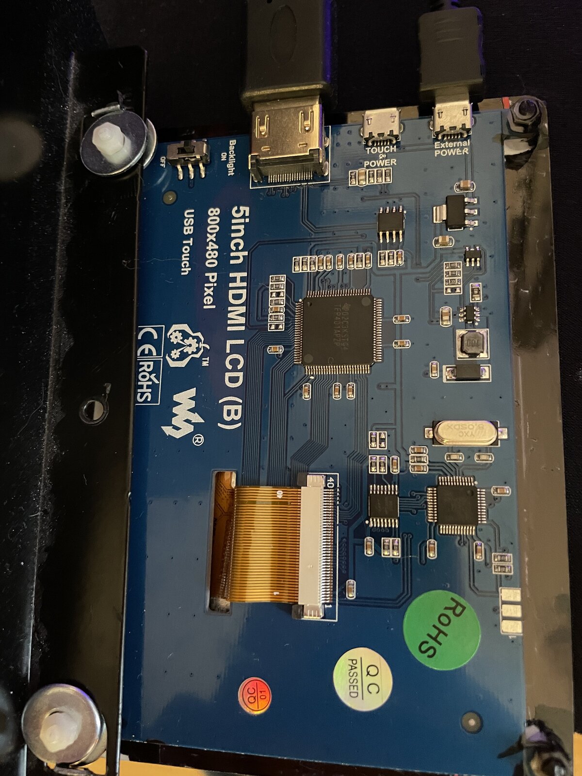

Hey @Seraksab ,
mh my PI3B and the v12.3 makes black screen.
I don´t see anything after first start, then i configurate it via iphone and selcect WaveShare - LCD5-show and restart - black.
Same with add my parameters in the config section.
*with the v11 the screen goes on at the first start.
I make a picture from my screen - is that the same?
I do not get an image on the first boot either.
But after configuring the Waveshare LCD5-show driver and waiting for the Raspberry Pi to reboot twice, the screen works just fine.
Do you do anything else after hitting the ‘Apply’ button in the configuration?
Are you sure you selected the correct driver? Maybe you selected the ‘GoodTFT LCD5-show’ by accident instead of the Waveshare one?
And yes, the screen appears to be exactly the same.
hey sorry, i am busy last weeks, i will try it today
nope, i try it the same way as you, Waveshare LCD 5 Show, nothing else, waiting 30min , available via browser, reboot again, nothing, is there a problem with the raspberry pi 3b?
try to add this in the config
this worked for me
dtoverlay=vc4-kms-v3d
