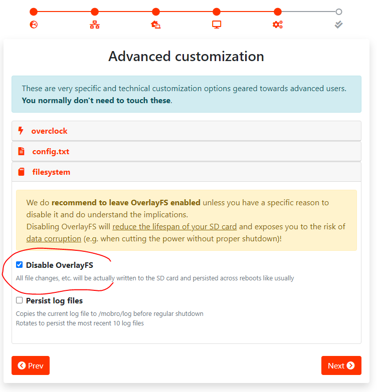

The whole thing seems to be related to the use of OverlayFS, but unfortunately I haven't found the root cause or a solution yet.. :(
So as a temporary workaround for the meantime it may help if you just disable OverlayFS in the ‘Advanced configuration’ step of the wizard like shown below.
Sorry for the late reply. Yes I used the previous version and everything worked out great. Will try setting Overlay to Disable. Thanks
Update. Going thru ethernet with Overlay disabled and with IP address entered in manually I got the PI to connect with both the network and the PC. Still wont work with wireless however. And the model is a Raspberry Pi 3 Model B.
