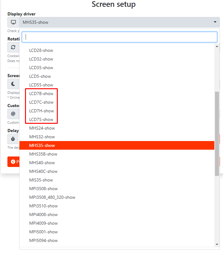

Connect your raspberry pi to a “real tv” with hdmi, you probably see the picture.
After this, in the wizard, look your screen driver.
Here is one of models available (not limited to), you must consult the user manual or the product webpage for see all details about your display.
The most popular and common drivers package is LCD-show, from GoodTFT : https://github.com/goodtft/LCD-show
Other debug solution, is install Raspbian OS (Raspberry OS) and try to boot from them. If your display work, is another problem. If you need to install driver, note the name of driver, is can help for solve the problem with MoBro.
