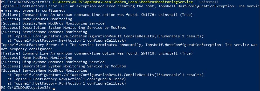

I still can't uninstall it, even after the update
@karuya
calling ‘ModBrosMonitoringService uninstall’ instead of ‘--uninstall’ should do the trick
although the service should actually be automatically removed when uninstalling the app. I guess we'll have to take a look at that again
any feedback you wanna share on why you are uninstalling?
@Seraksab
no luck with either of those, when I do “uninstall” it doesn't recognize it as a command. I am uninstaling because I used the app to show hardware info on my old phone as a display in the pc case. The phone is dead for some time now, and I don't use the app anymore.
What error are you getting when just using ‘uninstall’?
We're using Topshelf for the background windows service, so calling it with ‘uninstall’ should actually work.
You can have a look at the topshelf commands here.
