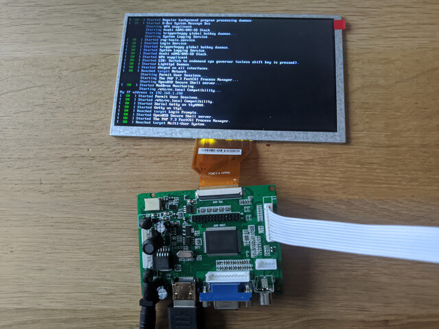

I am running a Pi2. I have bought a 7"inch non touch screen 1920x1080. It has several inputs like HDMI.
I have connected by HDMI

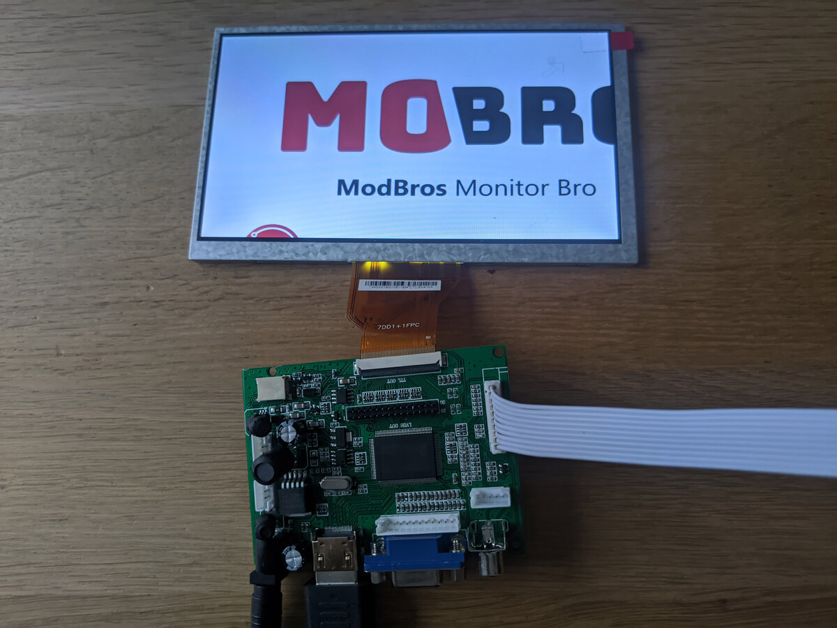

But I can't get modbros scaled to this size. I have tried several drivers and also tried to adjust settings in raspi-config.
Is there somehere else a setting to scale it wel?
The modbros image is too big. Missing screen right under.
Edit : I guess it has to do with the hdmi handshake.. I will take some more time to investigate.

@Racoon Thanks for the tips…. ThatsThat's exactly what I have been playing with yesterday.
But unfortunately nothing changes.
The resolution and aspect ratio changes on the console (start up) also in the display menu you see resolution according the config txt.
But as soon it boots in the modbros screen it's too big.
I am in a dead end…

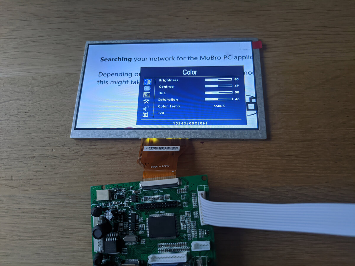

Could be the driver board is bad. OSD menu is not in the middle. Seen on YT the same screen and driver combo and the OSD is in there in the middle…
See images: image url upload was not working.

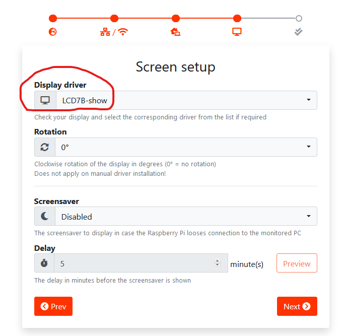

According to your screenshots, you have a 1024x600 screen or am I wrong?
You can try to use another HDMI driver from the raspberry configuration page. Personally I use the LCD7B-show.
https://www.mod-bros.com/en/faq/mobro/raspberry/setup
You can check their code in this gitHub I guess: https://github.com/goodtft/LCD-show
Wish u luck.
Unfortunately nothing helps ☺️
And I guess it's 1024x600 Saw somebody on Banggood with that comment. While it was sold as 1920x1080
I flashed Buster with Desktop and everything works fine… it scales in full screen.
Every time the Modbros screen comes up it's just partially imaged.

But with every resolution I get the same issue as seen in the pictures.
The only thing that changes is the resolution of the “console” startup screen.
