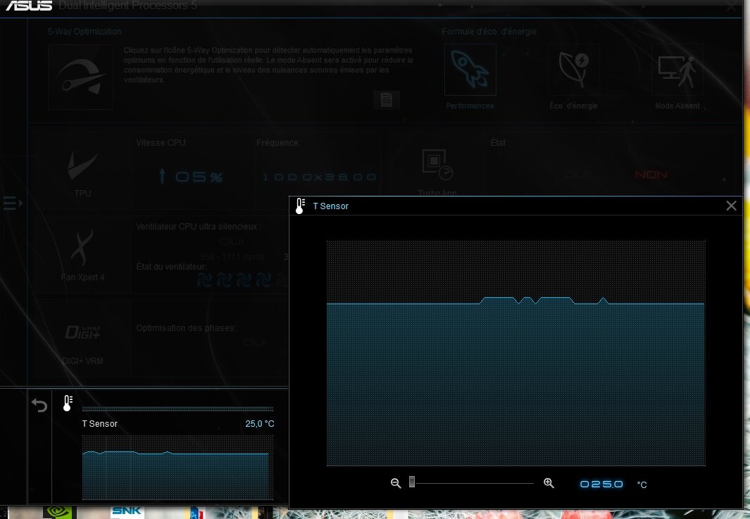

Hello, i would like to  include the T sensor in the widget modbros. I cant  do it with AI SUITE 3 ASUS. But what can i do with mod bros ? Thank you
https://ibb.co/SKNLVjt

depends if we get data from the sensor you are talking about. You can try installing hwinfo and run it in sensors-only mode. Once it is running we fetch data from hwinfo as well and this way it could be possible that we retrieve data from the T sensor.
If you want to display this value on an external device, you could adapt the dubbadhar theme. You can check out this guide https://www.mod-bros.com/en/blog/b/configure-themes~916 and this topic https://www.mod-bros.com/en/forum/t/dubbadhar-theme-bugs-issues~1136 for more informations. You could adapt the theme-config.json of the dubbadhar theme to point to the hardware type that you need and even set the sensor in you mobro software in the settings > sensor data.
This way it could be possible to get a widget for your T sensor.
What T sensor is this anyways? Is it a custom sensor that you placed in your PC or directly form your motherboard?
