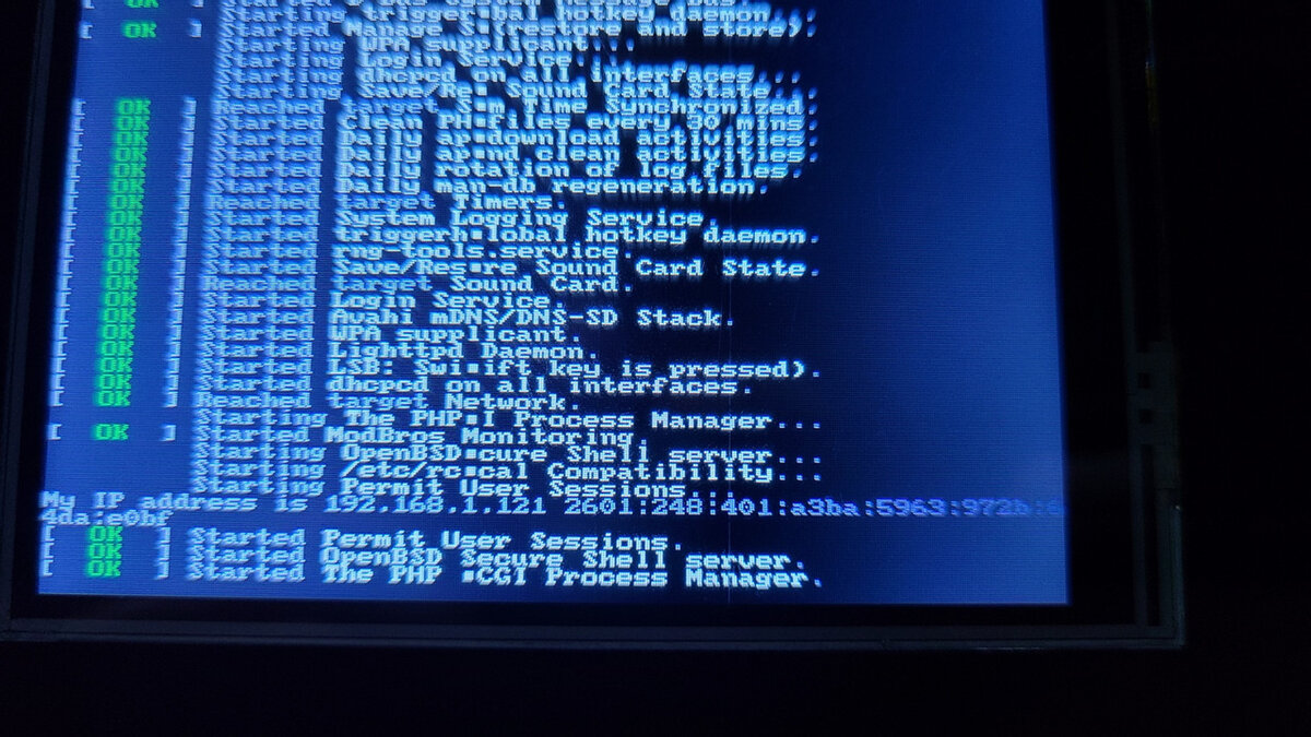

successful pass setup wizard and also install drivers for LCD with no problems.
however it's freeze at “ The PHP CGI Process Manager ” during booting and i can't do anything.
Desktop app works fine and detect Raspberry PI 4 as should.
Hi @Janlachut48
just so i can understand the situation better:
first time your Pi 4 booted up there was nothing shown on the screen as you hadn't installed the driver yet, right?
then you went through setup, installed the driver and now the Pi booted again and the screenshot is what you see.
but it stays there and never shows the MoBro app?
and at the same time the desktop app shows the Pi as connected?
if that's the case, the MoBro app on the Raspberry Pi seems to have started correctly, connected to network and even located the PC. but somehow fails to display anything.. :/
which display and driver did you use exactly?
and if it's a display connected over HDMI, which port did you use?
