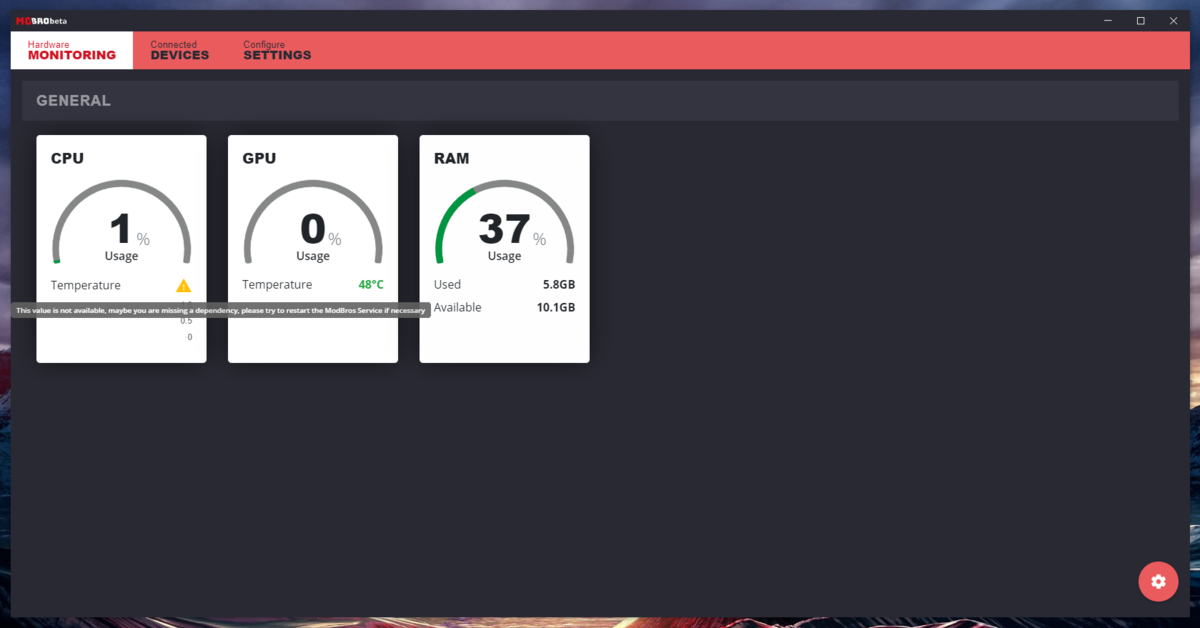

I'm having an issue where my CPU temperature can't be displayed. All I'm seeing is an error message stating “value is not available, maybe you are missing a dependency”.
I've installed HWiNFO and Open Hardware but I can't seem to get ModBros to display the information.

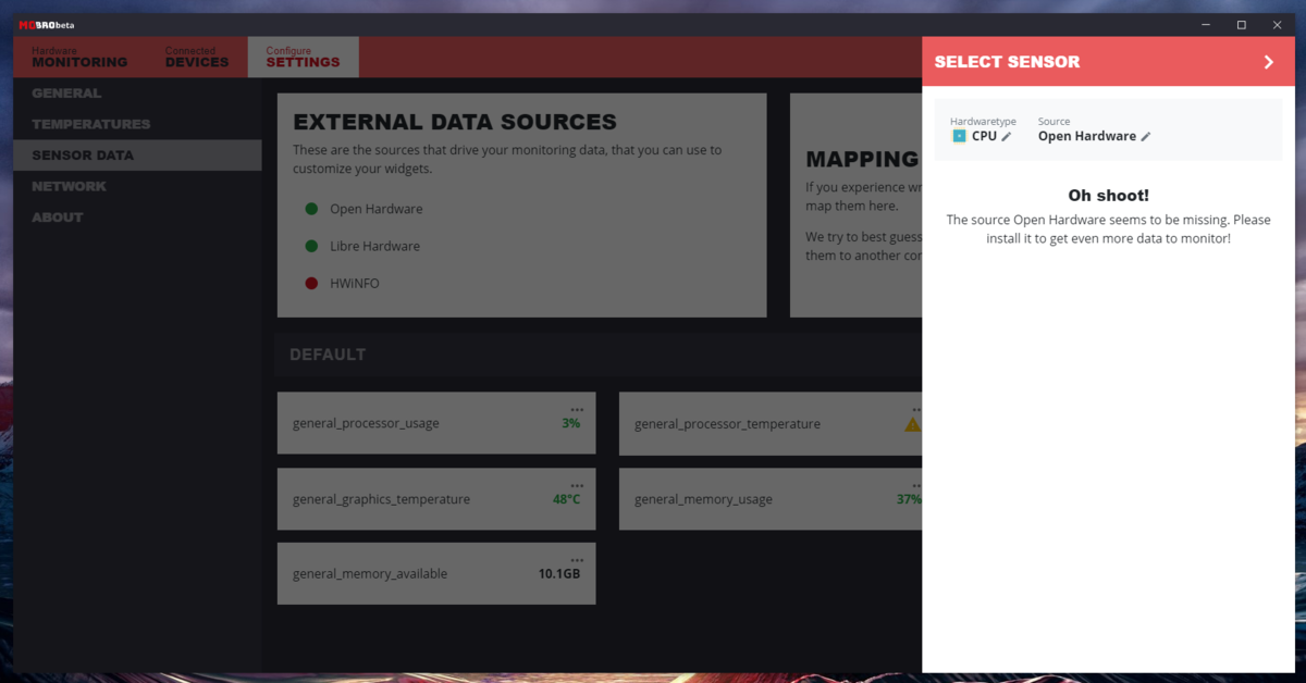

I have a Ryzen 5600X, everything looks fine on localhost.
Tried running HWiNFO on sensors only but ModBro is still telling me that I need to download the software.
Have you tried installing HWiNFO as described here?
Hello, same issue with the same processor (5600x). OpenHardware correctly displays my temperature so that's a weird issue for sure.
Problem has been fixed.
I uninstalled and then reinstalled HWiNFO, then ran the sensors only option again, ModBros started displaying CPU temps on my Pi straight away.
