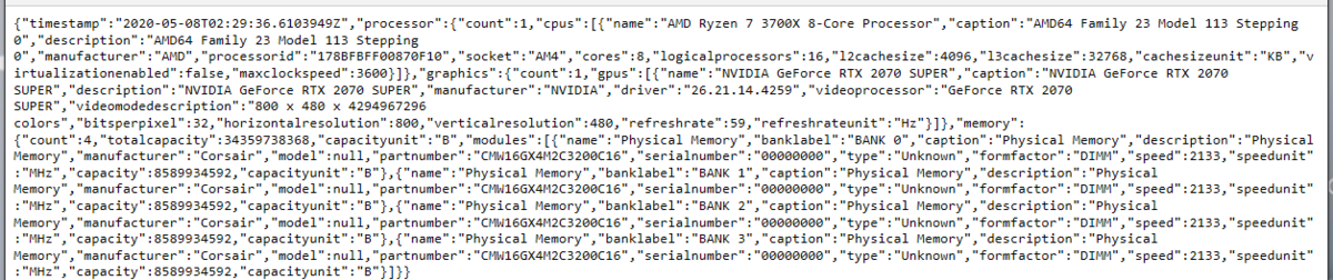

Hey McMack,
could you please try opening this route on your PC running MoBro: http://localhost:42001/api/hardware/data
If it shows up a JSON text we'll have to dig deeper, if you receive an error page than that is the issue. If you get an error page could you please post the error stack from the page here?
Thanks ~ Dave
All seems to be well here.
