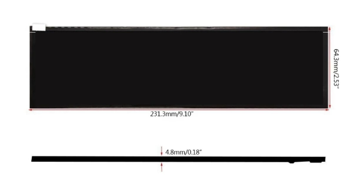

Another question! Would it be possible to use a 1920x480 screen? Like a long strip screen? I doubt it is because of the resolution but worth to ask! :)

If the screen is supported on the Raspberry Pi, I guess it should work.
But none of us ever actually tested such a screen, so I can't tell you for sure.
So if you end up trying, please report back whether it worked ;)

However my question then is, how does mobro handle the aspect ratio? seeing as the aspect ratio would be 4:1
