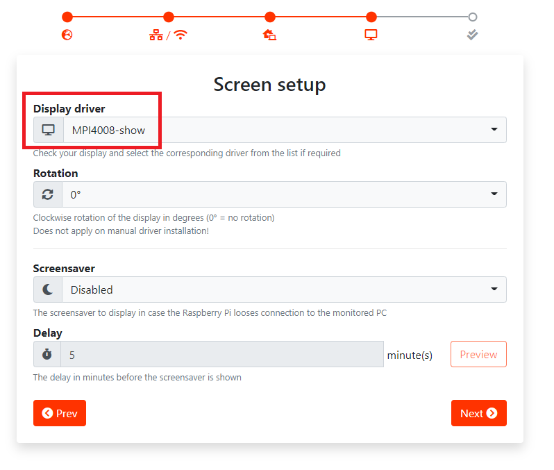

Just to let you know, the driver for the display you got is already included on the MoBro image.
Next time you could just select the MPI4008 driver as shown below in the configuration wizard:
