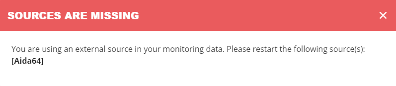

I have a strange problem with the integration of aida64.
It has always worked for at least 6 months but now, if I look in the settings of the desktop application, I get the error "sources are missing" (see screenshot below).
I could not get it to work at all.

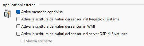

The 'Enable shared memory' in aida64 is active (screenshot below is in italian, the first one is the  'Enable shared memory').

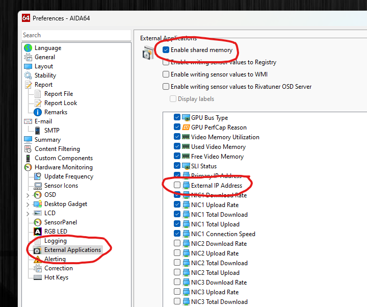

As it looks right now, there seems to be an issue with the way Aida64 is determining the External IP Address of the PC.
Some raw HTML error content is written to the shared memory file and consequently MoBro fails to parse that file.
You can “fix” this for now by just disabling the “External IP Address” value in the settings.

Hi Seraksab,
a few minutes ago it fixed itself... I don't know what it was.
If it happens again this option will be the first thing I will try to change.
