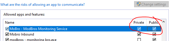

Did you already try to manually add an firewall exception like described here?
Also keep in mind that if e.g. you configured your network as ‘public’ in Windows, you need to enable the respective profile on the firewall exception as well

Yeah, I added it both through the app, deleted the rules then did it manually.  But no go unfortunately.
The MoBro Inbound rule was installed correctly by the app as well?
It's a bit difficult to troubleshoot these issues, since it's so dependent on the individual network setup and configuration.
All I can really tell you is that the Android app will connect to the PC on port 42100. So that has to be accessible.
But that should already be handled by the ‘MoBro Inbound’ rule that is installed by the app.
And then the MoBro desktop application will also need permission to communicate through the firewall, which is why we added the manual rule.
