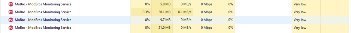

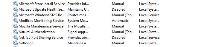

I've been using ModBros for a few months now, recently the desktop application has stopped working, it is running in the background through the task manager, I have tried any solution I could find on the forums, even unrelated solutions. Reinstalling, running as administrator, changing firewall settings, making sure the service(.msc) is running, my error logs are empty. My pi will forever search for the missing application, are there any solutions i have not been able to find, or are there any suggestions to try before I give up?

the app is starting and you shortly see the splash screen popping up? What happens afterwards? Does the app open in your tray?
If not, how many processes of mobro are running in your task manager?

Once i open it again any time after the first run, nothing will appear on screen, and the processes appear in task manager without a tray icon.

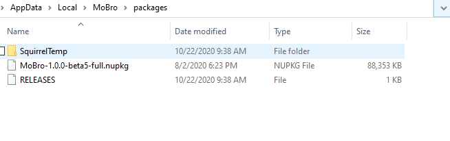

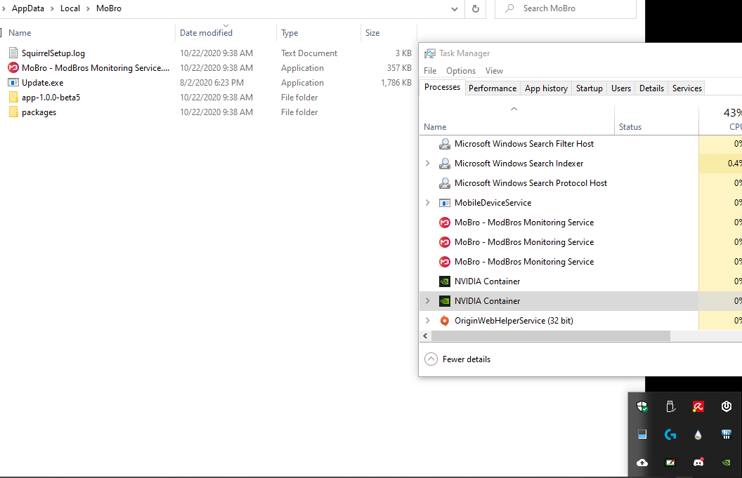

So the version beta2 is running for you but the beta5 always crashes on startup? Could you send me screenshots of your "C:\Users\<username>\AppData\Local\MoBro" directory and its subdirectories? Maybe there are some zombie files that could not be removed on un / install.
Can you try to uninstall and then completely wipe the "C:\Users\<username>\AppData\Local\MoBro" directory? That might help.

I did what you suggested, uninstall and delete all the files, and reinstalled beta 5.
Uninstalled, deleted the files, installed beta 5, splash screen appears and disappears, restarted my machine, and then took these screenshots.
These screenshots are taken right after I restarted, you can see the application running with no tray icon and missing service.msc, when i go in and start it manually nothing changes.

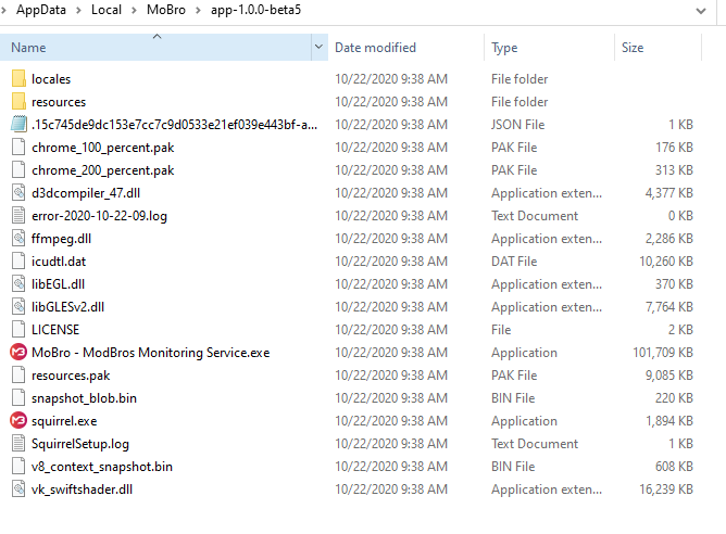

Hmm nothing unusual there. Could you send me the error.log and the SquirrelSetup.log? maybe via drive, dropbox or something equivalent
Hmm ok nothing there either, pretty strange. Could you zip the whole Mobro and Mobro_local folder from appdata? Maybe I can find somthing there. Thanks for the effort man!

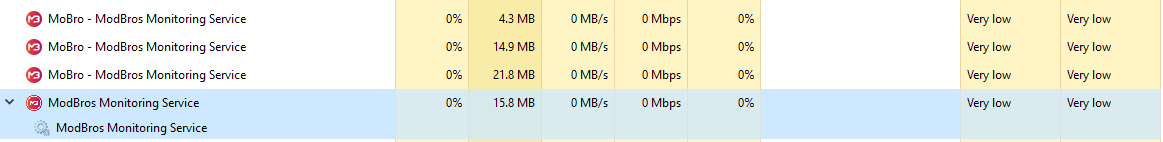

I am having the same problems as the poster.      The real issue is after I uninstalled the app it is still being run in the background which means the uninstaller is having issues and not uninstalling the service.

  2. Go into task manager and kill the Mobros process
