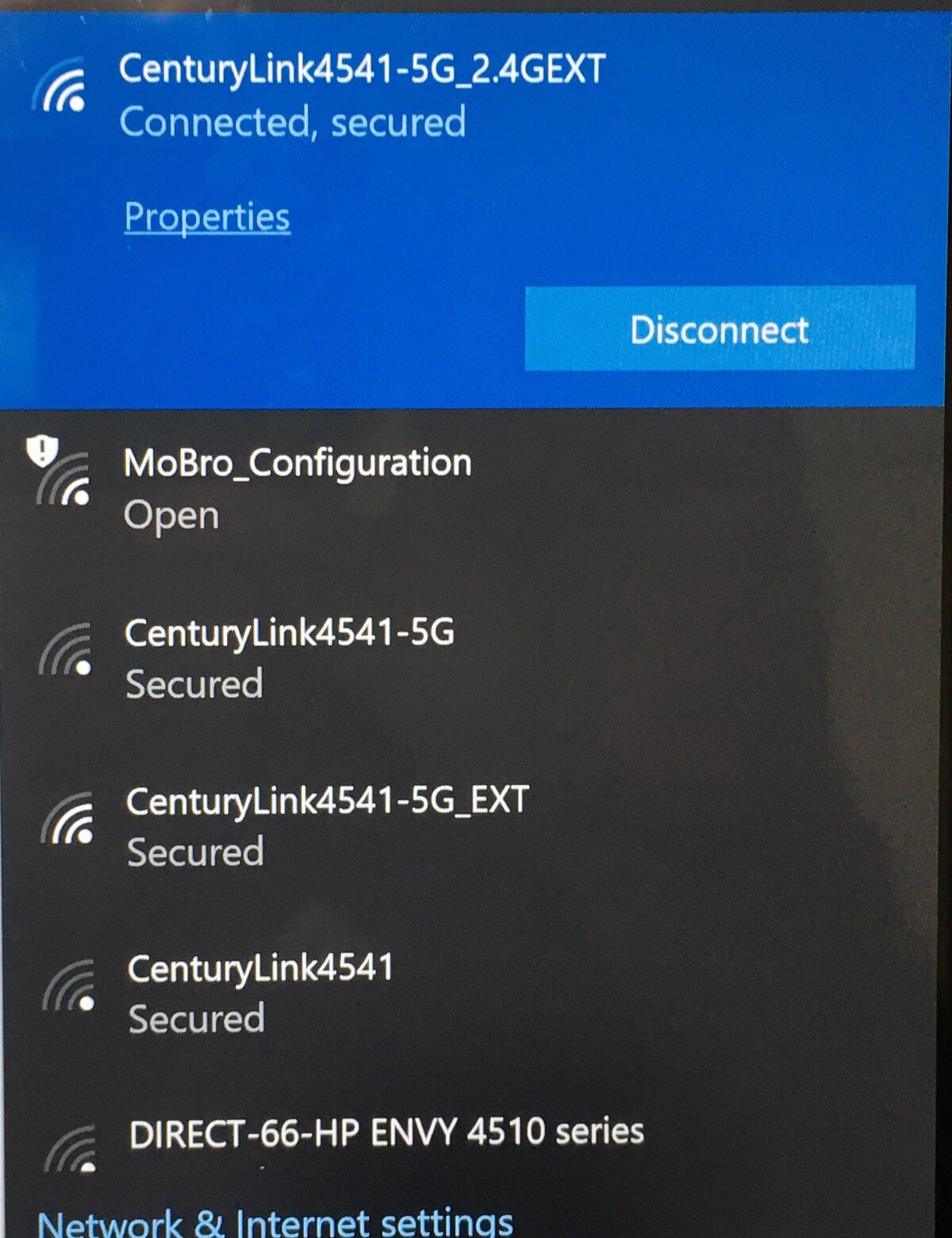

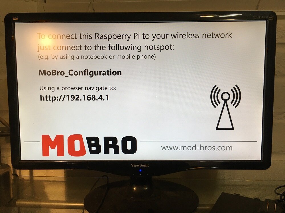

I reloaded the Pi software from your site and got to the point in the photo. I am unable to connect to the hotspot on either my laptop or iPhone. Typing the http://192.168.4.1 doesn't connect to anything. I must be doing something wrong at this stage.
I have a UCTRONICS 3.5 inch monitor attached, but it will not show up until I install the drivers. I had the screen working before deciding to try to use it as a hardware monitor. Thanks
Alright, but the hotspot is created and you do see and can select it on your phone/laptop?
Do you get any error when trying to connect?

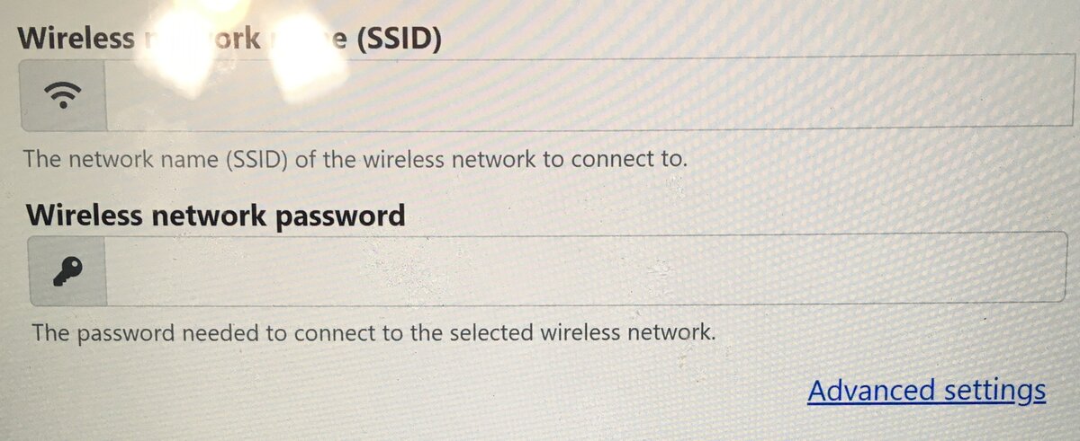

I have finally connected to the hotspot and got to the Configuration Wizard. I entered my network information and continued. The Raspberry Pi rebooted and located my network successfully and now appears on the monitor that is connected by the HDMI cable(not the one plugged into the Pi) as a white screen with a small red, spinning box for the last 30 minutes.

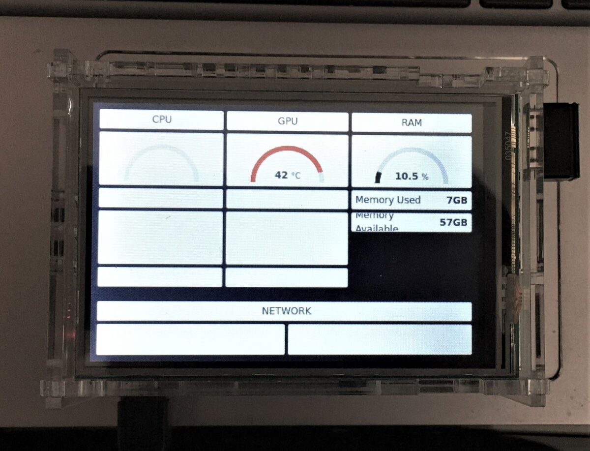

Hi. Thanks for all the help. I logged on to the hotspot and went back to the Configuration Wizard and and selected your LCD35 monitor drivers on the drop down list and it loaded beautifully!(I should have trusted it to begin with) Just need to finish setting it up.
