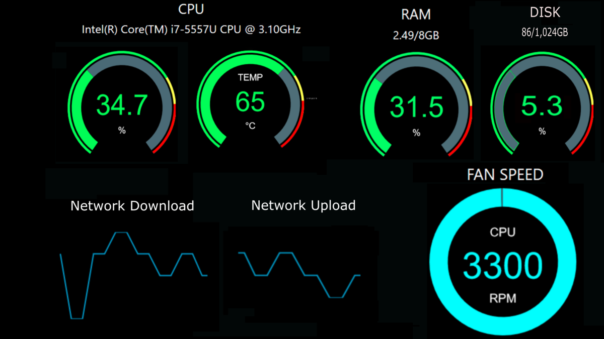

Ok, so I got basic gauges working but it's not showing good values even when modifying json for dubbadhar theme.
I have a basic render of what I am looking for, but my local current.json file values aren't recognized in any theme.
This link has been removed by an admin
This image has been removed by an admin
Basically, here is a render of what I am trying to do:
Autostart is up and running but gauges aren't displaying any useful info using any theme including dubbadhar

Render: https://drive.google.com/open?id=1GM4ZlbiHV4jpoU1LsOcWTklrPhE49wCE
Hey @AeaRy,
I think i got the gist of what you are trying to do. For certain things you might be able to get the data that you want on your RPi using the dubbadhar theme. You can use the theme-config.json file from the dubbadhar theme https://github.com/ModBros/mobro-theme-dubbadhar/blob/master/theme-config.json and adapt the channels by changing the includes values for the “byLabel” extractor to the labels of the data that you want to display.
It will be necessary I think to even add new channels and listen for their values like here https://github.com/ModBros/mobro-theme-dubbadhar/blob/master/src/js/script.js#L149 and adapt the source code of the dubbadhar theme to get what you want.
For that you will have to install npm and node and compile the theme using webpack with the command “npm run build”.
If you want to find out which values you can extract check out our blog post here: https://www.mod-bros.com/en/blog/b/configure-themes~916
~ Dave
