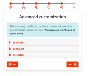

3. New 'Advanced customization' step
We've added a new 'Advanced customization' step to the configuration wizard that is geared towards more advanced users and allows you to:
- Overclock the Raspberry Pi 1, 2 and Zero (W) without console interaction
- Disable the newly added OverlayFS for custom use cases where its not needed or wanted
- Enable log file persistence for debug purposes
- Make custom additions or overrides to the 'config.txt' file
