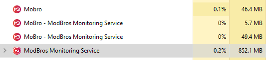

Just curious if you are aware that you have a memory leak in this service.  It starts with 36MB of memory used, once it has been running a day it has already consumed nearly 2GB of memory.  This left unchecked will consume most peoples available memory in a few days.

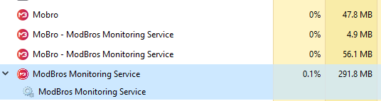

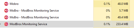

almost a straight climb within 10 min for me.

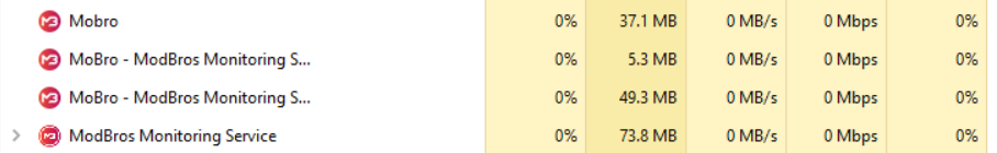

@Seraksab This one is working for me.  Uptime for 2 hours and hovering around 75mb for the main process

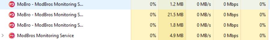

Sadly not for me. ~2 hrs
After another hour it looks like the memory usage is refreshed.
EDIT: Actually, the service stopped randomly and was prompted to restart.

i have noticed the same issue, been running for about 30 mins and already using 257 MB ram.

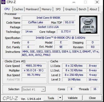

Old computer, FX8350, gtx 1080, 32GB ram

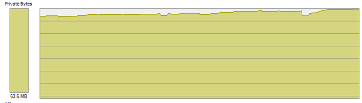

1 hour in. I'll keep an eye on it.

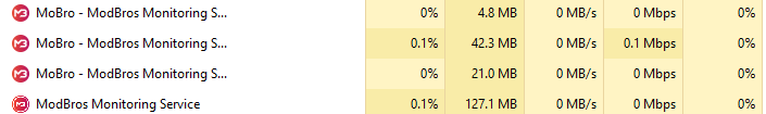

Similar experience after one hour
MrSpoon

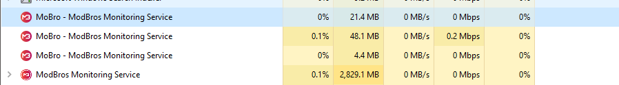

after ~12 hrs. At least the service is still  running.
My memory usage gets above 5GB on the regular. I do use a combination of open-hardware and Hwinfo.   @Seraksab if your team would like. I would be willing to let you remote in and look at the service while it's doing. this. it sounds like one of those oily pig kinds of problems.
