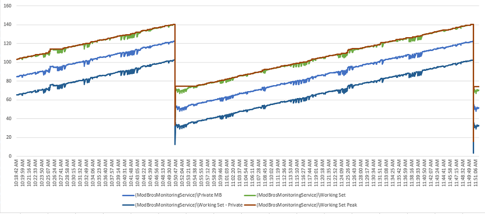

Looks like its been working as intended. ~2 hr snippet showing hourly service reset.

Well, finally. Glad to see this “fixes” the memory issue :)
